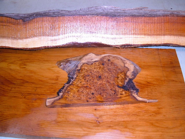

Here's a quick grab of some stuff in the shop. True yew burl is rare. The long quartersawn piece has the widest sap ring I've ever seen in Yew and I'll cut this piece for lute ribs eventually.

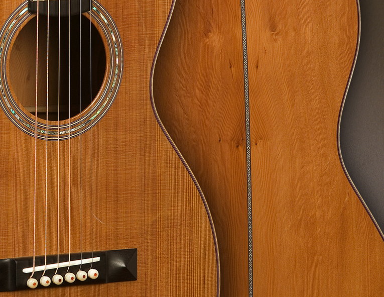

Hi,
I have recently upgraded my computer, and it will now allow me to participate in the forum.
I am posting a photo of the Yew Parlor that I had at Healdsburg last summer, and has been mentioned in this discussion. This is wood from the Olympic Peninsula in Washington, cut by some furniture making friends of mine 25 years ago. I got a piece of it from them back then and finally made something from it a few years back. I made a parlor out of it because that was as big as I could go in a two piece back. I choose a cedar top to go with it purely for the color match.
It is, I have read, the hardest softwood. It can be a dream or nightmare to hand plane, depending on which way you are planing/ the grain is running, tempermental to bend, and a dream to finish because of it lack of large open pores.
The guitar has a very round sound, almost like a nylon string guitar.
I reccommend trying this wood out if you can find it. Good luck, I have been looking ever since I got this set and have not seen anything that I would use yet.

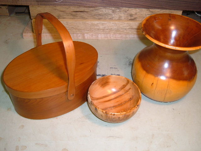

Rob, how quartered is the yew? I see some classic "pips" and pins in the wood. Hard to get away from that. I'm surpised at the bending comment as the stuff usually bends in a circle without breaking. The Shaker box in my photo is flatsawn yew and I bent that with no problem. I suspect it might have been that particular yew tree/board/board portion and is not a species wide problem. Yew wood fibers are entwined and splitting straight lines by hand is a very difficult proposition.
PostPosted: Mon Jan 30, 2006 1:45 am
Posts: 1051
I have also used it for Lute and mandolin (bowlback) staves and it does bend easily as Larry mentioned (if quartersawn) but the bigger problem has always been getting good stock for anything much wider.
For the Lute I used it on I really liked it and if it were easier to get I would use it.
Rob...Really nice parlor...good choice of woods. I am sure that the bending issues had to do with the grain of the sides.
